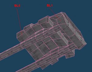

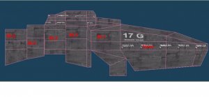

Well i am still alive here. I have started my RY but i am using the alt parts.I seem to have run into a problem that i hope someone can help me with.I have built the first 10 pcs.nose,NL,BL 1,2,3,4,5,bridge,and BSU L/R.I used the alt parts NL,BL2,bridge,and BSU L/R.As i started to assembly them they will not line up on the BSU sections.There is a gap between BL1,and BL2, and BL4&5 wont fit on the slope they end up about a 1/4" past onto the flat part.It appears either BL2 is too long or BSU is too short.Anyone have any idea how i messed this up?Pics r forth coming.wall1

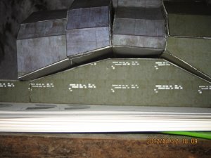

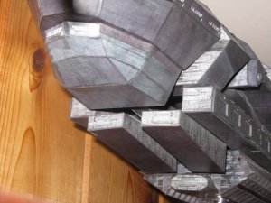

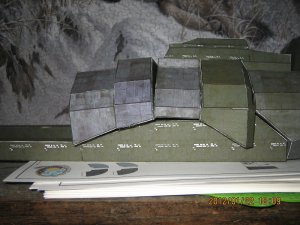

please dont laugh too hard at this build lol ....also need to know exact placement of the BSU's on the bottom. i had alot of pics showing what i did to make a sturdier build but i has a bad sd card and lost them. sry guys

Ok, I downloaded the instructions and I see what your working with. Everything looks salvageable to me. Just make sure your BL parts match the illustration and are straight. The BSU section is there to connect the bridge section to the flat mid deck platform aft, and will be (fairly) buried by the rest of the ship. I had a few gaps, but printed out extra mid deck platform sheets and cut the paper to fill in the gaps. It also did a nice job of tying one section of the hull to the next.
I work until tomorrow, but I will give you the measurement of the space needed between the 2 BSU parts. I glued my too close together and then had problems fitting in the wedge assembly.
You are doing great. Finishing this beast is an accomplishment.:wave:

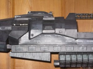

BTW, I never found a place for this part (last pic).

Roger, the parts should look something like this.
Also, very important, so your "wedge supports" fit between your launch bays, glue the launch bays at least 3 3/8" (inside measurement). Other wise you will have to glue the wedge supports below the launch bays....like I did.:curse:

Cool thx for the help... i c wat u r talking about.The piece u said u never found a place for is for the nose section to b used instead of the bigger one.I read this in a post on here somewhere i think.It was for ppl who wanted less nose.Your pics will help alot.Thanks again. Will upload more later.
