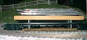

steamhead
This is what I use to keep track clean....When viewed at a normal "layout height" you can barely notice it...
steamhead
Hey KevinK... it's a little device I manufacture and sell. It's a specially treated strap with a weight to keep a steady pressure on the rails. It keeps the track really clean and I don't have to worry about cleaning it...:mrgreen:
