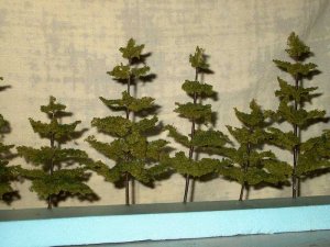

I then went on to the hard part. I used WS Foilage, light green. I cut small triangular pieces and pulled them apart as per the instructions. I weaved them up and down onto the branches. Then I sprayed white glue/water onto them and then sprinkled on dark green (WS weeds). The hard part is trying to push the foilage onto the wire. the wire is very soft and bends easy! But I think the end result is pretty good.
Any body fair to guess what type of tree they look like? (I had nothing in mind when I made them!) I just call them my lichen tree!!
