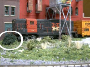

Xaniel,
Heres a picture where I used a chunk of Woodlands Sceneics Lichen(in the circle). I like it for making scrubby looking bushes.
