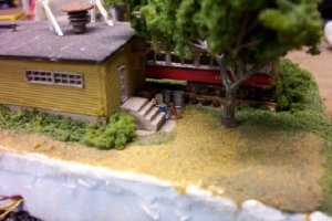

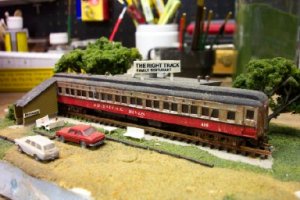

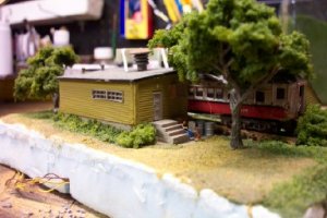

I don't know if this is what your looking for. But here's one I did in N scale years ago..
Its suppose to be an old retired coach someone converted into a dinner.
Hey Val...Can you use it in August?
