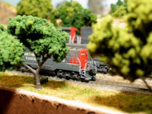

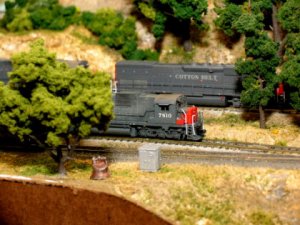

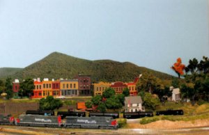

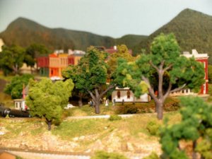

I took a few more pics this morning of the latest progress. Some scenery and details added. Landscaping, groundcover and ....

Nice photos Doc! I like your scenary and that tree covered hill background in the second pic. The petro industry looks great with all those pipes and tanks!

Very nice work TexDoc. Each element fits nicely into the whole layout.
The refinery is impressive and very "credible".

Whoa...back that train up! I just realized that you're doing Nscale - is that right? Ok...time to fess up...how did you get those DPM (is that the correct maker?) looking that good? I have built four DPM kits and due to my own limited building abilities, they turned out ok but not great. And painting all the window frames was a chore. Where did you pick up the roof details?

I am the first to agree that painting the DPM buildings is a giant pain. I airbrushed the individual pieces first. Colors vary. Depot Buff, some red (don't remember which) and a mix of trim colors. It is hard to remember since these are 10 year old projects, or older. In fact I had them stored for 7 years when I lived in Mesa, AZ with no room for a layout. The left end is the original "Main Street" which was the forerunner to DPM style buildings. Not the cheap plastic Walthers "II" version. It is four store fronts in one piece. It was the first building of this type I assembled. After painting the entire bldg. or in the case of the Main Street which was masked and painted different colors for each front, I masked the walls and painted the trim, frames, ect with a very fine tipped brush. Some touch up on the walls was necessary at times. I have black construction paper attached inside covering all the windows since the town is away from the edge of the layout. The roof details as an assortment. Most, especially the AC units, are Cal Freight (i actually got a few new pieces a couple of weeks ago thanks to Neal at Neal's N-Gauging Trains.
