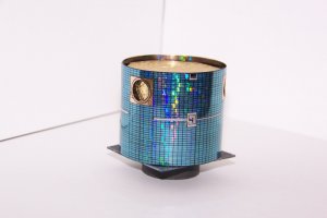

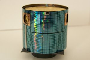

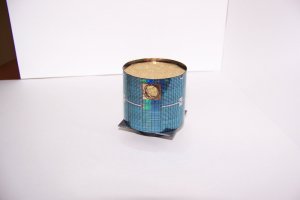

Hello. and good day, I have finally gotten a chance to retrieve an old and as yet unfinished model, but it features a test run on my idea of achieving realistic looking photo voltaic grids or arrays.
The model in these pictures is a couple models thrown together quick for structure, printed from one of the links at the ninfinger site.
I will try to make this short and sweet.
The first thing i did was print the solar cell grid onto a piece of clear acetate that had a blue tiny to it
After printing the solar cell pattern on the acetate, I lightly sprayed it with a gloss protective coat and let it dry.
I then reprinted that same image onto a sheet of both gold and silver bare metal foil, so that individual elements could be cut free and applied to the surface of the satellite shroud, where appropriate. You can see where that is done.
The last think I did was to take a sheet of that silver prism adhesive myllar sticker sheets you can get at craft stores, and lined the pattern up so it was straight with the grid lines, and working forward, to avoid trapping any air bubbles or wrinkles, carefully, laid the acetate image printed side down against the sticker surface, then burnished it down and there it was.
Since doing this test run, I have tried mylar prism sheets with different patterns on it, and the one that I have decided looks the most accurate, is a sheet thaat has that pattern that looks fractal and like metallic shards of broken glass, pressed paper thin.
I applied that to the back of a piece of clear blue acetate as well as just plain clear, with a grid printed on it, and the result looks spot on.
I hope this all makes sense and helps anyone who is interested.
Note though, that it is trial and error, as I tried this on another piece of acetate, and when trying to print the image of the grid, the ink was not nearly as successful. for some reason, subsequent print trials on different acetates,had the ink pooling or beading up.
I dont know what the difference was in my first couple trials, except beginners luck, but the pictures show that the method is effective if you have the correct acetate material.

Rogerio, thank you immensely for the very kind words.
I would be glad to do an in process step pictutorial. I'll also show a couple of the other foils I have that have a better effect.
regarding the technique...my long windedness made the process sound way more complicated than it is, so I apologize for that first of all.
If you look at the one pic that is a really close shot, you can see that the pattern in the solar cells has sort of a continuous rows of interlocking circles sort of look.
What you're seeing is the back,raw, untinted side of a sheet of prism adhesive backed mylar "paper"
The other (front) side of that sticker paper, actually has a weird brownish coppery tint to it. If you look close at a few of the pics, you can see the top inside edge of the cylinder...that dark burned copper color you see, is the front side.
So after i printed the image of the grid on the acetate, i simply cut an approximate size away from the stickered mylar, placed it face down, and peeled the backing off the sticker side, then taking one edge of (the roughly cut to size) printed acetate, just laid it down and slowly worked my thumb forward, while holding the other end up off the sticker, slowly working it down.
then i just used a napkin and pushed it down on the acetate and worked forward, just the same way you would when trying to apply a sticker to a car window,jst getting a nice clean bond.
once its down, youre commited..and even if you've just started an end and have to readjust it, it will pull the ink off.
Its a good even clwan adhesive though and doesn't give any kind of silvering or weird foggyness or un evenness.
I hope that was a bit easier to understand.

and if i understand your first question right, the bare metal foil was actually applied on the out surface once it was all done. Is that what you mean or did i miss it?

The bare metal foil was actually the stuff you can pick up at local model shops. actually its the aluminum and gold BARE-METAL FOIL (tm).
The model is a bit old and has been handled enough to have worn the ink off of the metal foil bits.
This was a simple test bed model to try out different tricks, hence the very simplified details.
