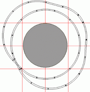

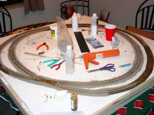

Ahh it begins. Here's my non-serious layout. I think it wil allow me to practice some landscaping techniques. :) I bought woodland scenics snow and about 50 feet of Atlas flex track and some roadbed.
pgandw I like the idea of the 1x3 pine. And the foam base will make it easy to make a hole for the tree stand. I think I'll surround the tree stand with a mountain.
I'm going to be running a smaller steamer and some short coal cars. Fun. I'll post pictures next week.

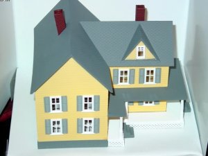

Anyway I need some suggestions on a Victorian house. I've been looking and looking. I'm not going to be a good candidate for scratch building one so we can rule that out. I'll need one with some detail. Any suggestions?

You can go to www.walthers.com type in Victorian House and Search. Some come up. I had a cheap (life like maybe?) haunted house that was victorian, If you don't put in the boarded up part of the windows, you wouldn't know the difference. (Except for the ghosts, lol:eek::eek:)

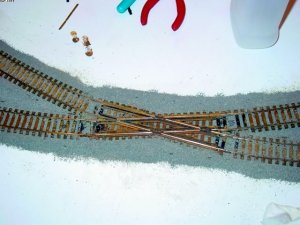

Earlier in this thread I posted the track plan. I decided recently to remove the 19 degree crossover and simply have the track go over the lower run via a bridge.
Since this will be a simple Dc layout do I need insulators? Forgive me if this is a silly question.

If you are only planning on running 1 loco, you don't need insulators. I don't see a reason why you would need them.

Well this layout is coming along. I'm using it to prep for my full size layout. Some things I have learned and have questions about. I promised I'll post pictures once I get my camera problems worked out.
I purchased and used Flextrack for the entire layout. It was difficult to place the flex track and make it come out the same radius continuously. I think I read a suggestion about using a yard stick to draw lines as a guide. (I'll try that next time.)

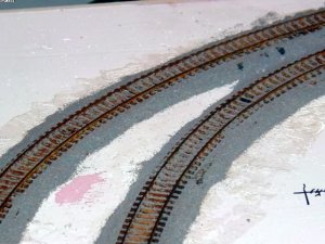

I used alcohol and a little liquid soap and my ballast seem to float a bit and ended up on top of the rail. I tried to use a medicine dropper and a contact solution bottle but it still didn't make a difference. What's the best way to clean up the tops of the rails?
I painted my rails and ties with Senna brown (someones suggestion here) Seems to too light. I may weather them a bit more or hit it with the Midwest liquid weather stuff.
I tried it out a some test track. The bottle mentions that you have to rinse with water to stop the weather process. :( But the rails turned dark black. Not sure that's the look I'm going for.
I'm still ballasting... I ran out of alcohol.

You'll notice the ballast started to float on the ties. I think I figured out what caused it. Instead of dumping a lot of alcohol and soap on all at once... I started to do it little by little. Taking my time. :) How am I going to remove this?????
I believe that's why some areas are better than others. You'll also notice the paint on the ties seemed to get lighter. I suspect the soaking at a lot to do with this. A second coat will be needed.
The house is a model power. For the sake of time I got a pre-assembled one. It needs weathering etc. And some details. Suggestions?
