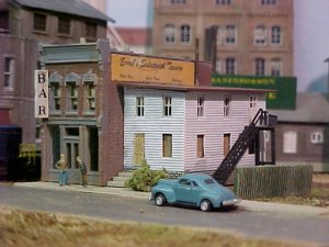

Here's what I like to do Don...
I use old kitboxes (basically the same as a cereal box) to represent paved streets...I use matting board (you can get this at craft stores, or anyplace that does picture framing) to make a base for the structure, leaving enough along the front of the structure to represent a sidewalk...(5 or 6 scale feet wide) In other words, sidewalks & structure bases are all one piece, planted on top of the street.
The matting board is a little thicker than the cardboard used for the street, giving me about a 6 or 8in curb...(N scale)
Hope this helps...

Yeah Charlie, excellent example. And thanks again to everyone. I'm sure I'm not the only one here to learn something from you guys.
I was thinking that cereal boxes were a bit on the thin side, I measured them at .020, or around 3" scale. Two layers, or thicker material would be better. I'm heading to town this morning and will stop by the 99 cent store, or a Wal Mart that has a fairly decent craft dept.
