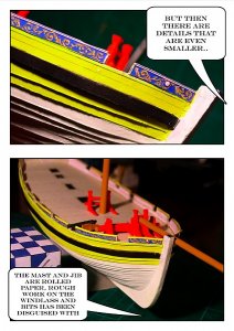

Little bit more progress on the hull front. The gap between covering pieces 6 and 8 was a little dicey but it was clear that the next set of hull parts would fit as intended.
The middle paper covering pieces are printed with the positions for the final planking and the clinker planking was a little nerve racking at first but it came up trumps!
Before anyone asks I have been doing a lot of dry fitting of parts to check dimensions and trying to keep everything the correct distance apart, hence the tiny clothes pegs.
Purists look away I am shamelessly using filler and paint in search of lovely bottom...

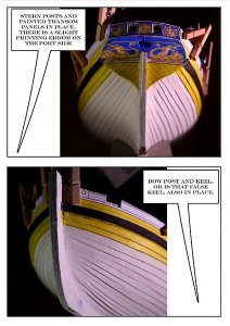

David H
Planking; well Le Coureur, the second part of this kit issue is also clinker built. I don't know about the others published by Shipyard. The clinker build technique does have a certain character and a lot of texture.
However, I have to admit I have no idea why these "little" ships were clinker built as opposed to carvel built with flush planks - over to the shipwrights out there.

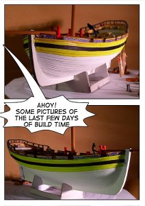

David H
Sadly not a lot of progress. A holiday week spent on lots of family cycling and building Peanut scale free flight in Depron foam. They fly!
Still a little movement on the Alert.
The register for the port sea monster is off so he almost, but not quite, runs of the edge of the printed area. A very small error and hard to see!

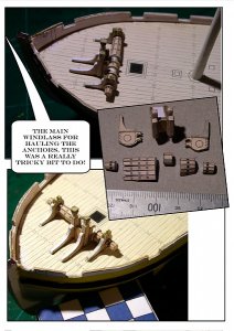

Little Bits...
Well I have made some progress even though Christmas has eaten away at my time and resources.
Shipyard do make you think. I would say that the diagrams are only just up to the job of building the windlass and other small subassemblies, but, I may be particularly thick this time of year.
The decorative bulwarks were fiddly but straightforward and very satisfying. I did deviate from the kit parts though, the narrow trimming pieces at the top are home cooked and will be trimmed down rather than kit parts which are too small for me to cut out and manipulate.

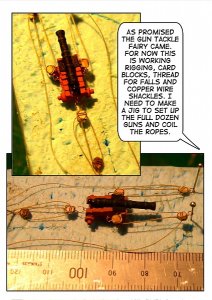

David H
Trying to stick with card as the primary material is a really dumb thing to do. i am sure some one will make an injection moulded ships block in a variety of sizes. Just cut it of the sprue paint it and use it.
No no no, that's way too easy. Better idea, lets sandwich together a couple of layers of card, drill some holes with a 0.65mm drill, make tiny wire shackles ( I really do not want to count them 3 x 12 guns, 4 x 12 block and tackle, and 4 x 16 for the gun ports).
The card de-laminates... the thread is being dificult and fraying... you know all the usual stuff! I may look for an alternative material for the blocks, probably wood as shown by Jerzy at http://www.boatmodelling.com.
So what do you think?
I still have the thick recoil rope over the cascable to do but a dry run seems to work OK.

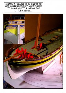

David H

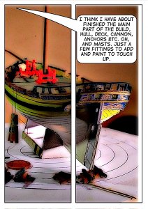

Just a quick up date.
There is no denying Shipyard kits are demanding, exacting and very rewarding.
However, the taft rail on the stern was fun and surprisingly easy.
