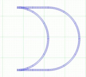

AFAIK the only snap switches Atlas offers in code 83 are #4's and they are pretty tight radius for multi driver steam locos or long cars.
Bob,
Actually the Snap Switches have a constant radius frog rather than the fixed angle of the #4's and #6's. It's an 18" radius through the frog, so you can make an inside passing siding at the end of an 18" radius oval:

Bob,
I knew that.... you told me before :p
its still tight for bigger steam IMHO but the locomotive binding or derailing will tell the story for sure.
Of course there is always the quality of the track laying....:eek:ops:
Addendum: if using #4 snaps and trying to make a passing siding along a straight stretch the resulting S curve could be the problem.... or of course truck mounted couplers... or out of gauge wheel sets... or
