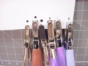

Catt, I agree, that is one of the most usefull tools when scratch building. Also in my tool weaponry is a variety of paper punches. Pick them up in my local craft store, usually in the section for scrapbooking. Here pictured are the ones I've collected and used. The sheet of white styrene pictured is .032" thick, and the punches go through it with no difficulty. Have to nurse the punch back out a little as the plastic kind of closes in on the punch. 1/32 is about the maximum for these type of punches, I've punched thicker but did mess up my 1/4 " square one trying to punch .04". Oh and don't forget to save the little punched pieces, they make great detail parts, especially the square jobbies.

Man, Oh Man...The great ideas just flow like who-knows-what around here. Thanks VERY much to Catt and Bill for those great tips. I'll be out looking for some of those babies before too long.
