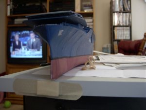

Continuing design and beta build of CV-6 Enterprise
This is the finished design and beta build of the hull plating sections up to the main deck- foc'sle deck line...now to take to task the construction of the decks up to the flight decks....then we'll see how an aircraft carrier takes shape!
:winter1: Happy Christmas! and Merry New Years! to all!!!:p

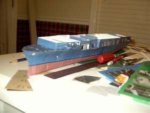

airbob
Continuing on designing and beta building the above the maindeck superstructure to the flight deck! This view from port bow above...
Happy New Years ,Ya'all!balloon6balloon6balloon6

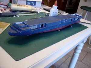

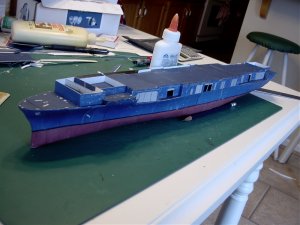

airbob
This is the hull "cleaned-up" before the addition of the flight deck....I should complete this sometime in the next week...this will be exciting!!!
bounce7bounce7bounce7

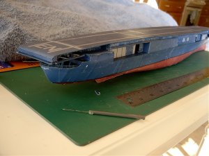

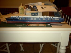

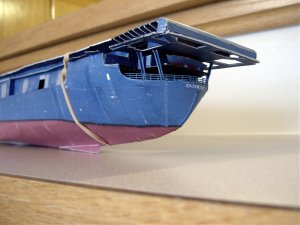

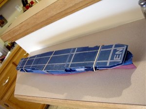

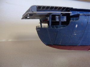

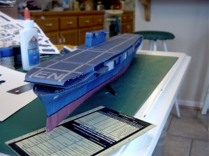

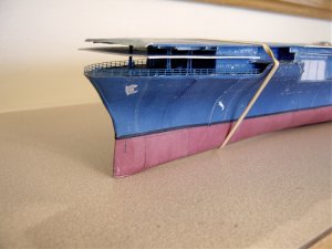

airbob
I have continued design and the beta build on the CV-6 USS Enterprise hull up to the flight deck....the detail of the bow and the stern were very complex and a real "brain twister"...now comes all the little railings!!!...maybe will tackle the control tower sometime later in the month if all goes well...the flight deck was just attached with rubber bands for now so I may remove to finish attaching all those little railings!!! Maybe time to celebrate a little!!!
:band1::wave7::rofl::rofl::wave7::band1:

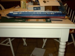

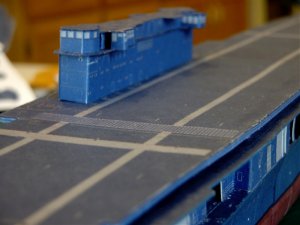

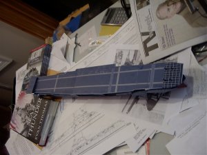

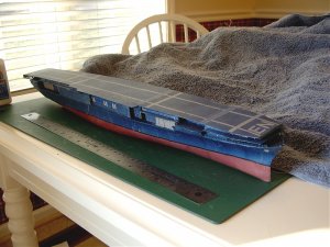

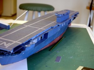

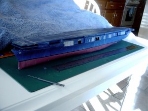

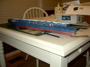

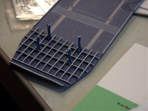

airbob
This is the continuing construction to finish with the flight deck...as you can see there are a lot of little bulkheads added at each station on the Galley Deck....I put 5mm pieces on top of these bulkheads to hold the glue betterfor gluing the FD...the flight deck has a very slightly rounded profile...especially at the bow and stern...maybe not as per the plan detail...but just one of those things that happen:p....however I'm not sure which part that I'll do next the control tower or the 5" multipurpose guns on the Galley deck...

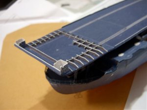

Flightdeck detail of CV-6 USS Enterprise
This is pictures of the detail of the under deck area of the (one) bow and (two) stern areas of the flight deck, the last view shows the detail of the under flight deck area with a 2mm "apron" attached to all edges except for the above bow and stern beam reinforced areas.:wave:

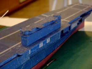

airbob
hese are some shots of the beginning construction of the flight island on the Enterprise....next up will be the funnel complex..
