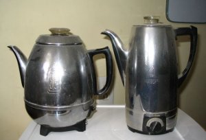

Dry Ice Idea Details
Ok, so you want to model Ol' Faithful. Now the problem with Co2 gas is that, it is just that, a gas, and once you release it, it goes up and out into the atmosphere and that's it. Plus the fact that all that pressure would not look like the real thing.
Now here is how I see this effect being accomplished. Get yourself an old coffee pot. Like the ones from the 50's, tall and metal. I collect old coffee pots and have a few of them. Some of them have lids that snap on, this would be a good thing, but not necessary. Now these old percolators have a basket for the grounds and it sits on a pedestal. Discard the pedestal and keep the basket. Drill 2 holes the size of a coat hanger wire in the lid, one on each side. Cut the hook off a coat hanger and straighten it out, then bend it into a "U" shape wide enough to feed the 2 ends through the holes. Do that and then bend a loop on the ends and hook them to the basket. This is all so you can lower the basket into the hot water when you want to.
now if you can't find a piece of rubber tube that fits over the end of the spout, then fins some that fits over a piece of brass tube and fix that into the end of the spout with some plumbers putty. 3/8" to 1/2" inside diameter rubber hose will work best to transfer the mist up to the layout. You will want to experiment with the nozzle before you build it into your module, to get the desired squirting action. Additional height can be achieved by drilling a hole in the unit someplace and then squirting compressed air into the pot while the reaction is happening. By doing this you would need less dry ice too.
So you wold have the coffee pot under the table top with about 3 cups of water in it and plug it in to heat up the water. Once the water was good and hot, lift the lid and put a few pellets of dry ice in the basket (if the glass perk knob is large enough, just remove it and stick the dry ice in there) When it's eruption time, lower the basket into the hot water and watch her spout! You will see the steam/mist will rise up and then descend down again giving a realistic look to it. It dose this because the mist is so cold. :thumb:
This will work. I have made a few special effects using dry ice for my puppet shows. I use to have a friend who ran a Dairy Queen and he use to give me dry ice that came in shipments of ice cream he would get on occasion. If you have a real good cooler, a bag of dry ice can last a few weeks. I had a space ship that flew in over the heads of the kids. It was about 2 feet across and hung on a long stick with lights all over it. And I tell you, when that dry ice hit that hot water, there was a wonderful reaction and the space ship would overflow with this mist. It looked great and made a big hit with the kids, who thought it was a real flying saucer. Dry ice is always fun.
TrainClown ;)
