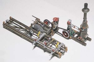

knudsen
That is a portable sawmill not suitable for an interior of a large sawmill. A nice kit for 10 clams tho!
