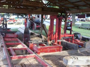

Sawmill Carriage pictures
willy4
Jan 17, 2008
76
Que Canada

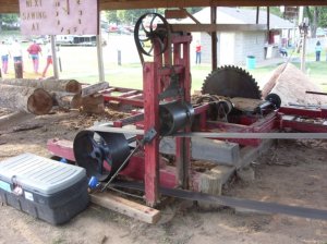

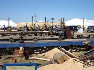

Taken at the International Plowing Match which is held once a year in Ont Canada.
Bill

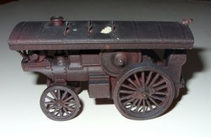

I aws at the Thresherman' show in Adams Tn (near Dr. Toms old cabin in the woods) I got some photos of a steam traction engine hooked up to a sawmill. I have and old Matchbox tractionengine, which I want to use with some modified pieces of a Woodlands scenics rural sawmill to attemt to replicanr a little mill like this. don't know where I will put it my own RR has two sawmills on it allready. pictures to follow.

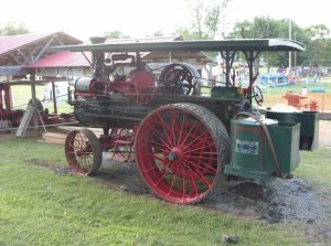

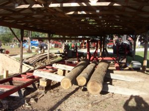

from the annual Thresherman's Show in Adams Tn.
here are the promised Pictures.
I have two matchbox models of yesteryear traction engines, one lives up @ a logging scene above Terrapin, and the other has been parked up near Stateline. the parked one has a roof, and is larger and will probably power the sawmill I'm thinking of.
I probably won't try to start untill I have gotten the Surry _Parksr project done.

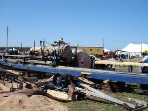

I think i posted these elsewhere on the zealot, but they're from a trip to a Threshing Bee i took last year.

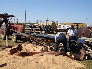

OK - I'm going to go ahead and ask a stupid question:
On those long belt runs, what keeps the belts from slipping laterally?
Bill Nelson
Dec 14, 2008
2,680
467
Clarksville Tn
I think the width of the belt will make the belt want to track true. as long as the belt is true, and the axles of the pullies are perfectly parralel. I'm sure there is a arcane art to setting these things up. there is a tensioner on the steam tractor setup I observed the other weekend, and that is modeled in the Woodlands Scenic's rural saw mill kit that I may rob some parts from. Perhaps there is some adjustminets on the tensioner

The belts do take a bit of skill to align with a tractor. They like this method rather than using the stationary engine, as the tractors can be put in sheds whereas you can see what happened to the big one powering the A-frame which pulls logs off the deck and onto the carriage, bad winters and wet summers. They quit using it years ago and now 3 guys with peaveys roll logs forward.
Then again, it's only used once a year (this year i think something broke down) and there probably should be a shed built over the whole thing.
Fascinating to watch in action! :thumb:
Hey Mountain Man the only stupid ? is the one never asked. If you notice the wheels that the belts travel on are very much wider than the belt. Perfect alignment between these are impossible due to many factors,vibration,dirt,moisture & tension changes. With normal use the tracking of these belts are constantly changing & because of the wide width of these wheels the belt normally corrects it's self. With caution if you have a belt sander turn it upside down & change the tracking slightly & watch the belt it corrects itself very quickly. It will go to one side or the other but equals out between wheels. If the wheels on the sander were much wider like those on the mill the change in tracking wouldn't be a problem.
Usually the pulleys are not perfectly flat on top. They usually have a high spot right in the middle. Naturally, as the belt rotates on the pulley it tends to ride up to the high-spot.
Also belt dressing is applied to make the belt that much stickier. This can make a big difference and reduce slippage. For steam traction engines you will note the ones that work on a belt usually do not have painted flywheels. The paint tends to be slippery and wears off quickly.
On long belts it is common to apply a twist to the belt. This will help reduce the flapping from heavy winds.
