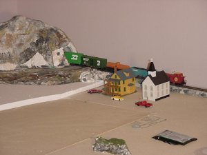

    I'm trying to run 2 separate trains on my 4'X 8 "L" shaped layout. Can I use 2 radius curves at the points where the tracks will cross each other? Any suggestions for my second power pack? I can use all suggestions and help in doing this. Not sure where to put the second track. The first one goes up a riser and through a tunnel along the outer edge of the layout.Just starting and know nothing about power packs except the one that came with my set. Thanks for your time and help.

    I don't know how to post a picture or diagram on here. I'll try to do it. I want 2 seperate trains on 2 seperate tracks. I have a Southern Pacific ho track and train running all along and around the outer edge of my 4'x8' "L" shaped layout / up a riser and into a tunnel. I ordered an Am trak fleet and I want to put it inside the original track but I'm having problems getting the curves to fit. I hope I've made myself clear enough. I have a problem putting images down into words. Please have patience with me guys. I really want to do this. It's always been my dream. Seems to be getting complicated though. Thanks to all of you.

    Photo's can be deceiving, but that pic doesn't look like HO scale. With a 4' * 8' layout, you would just be able to fit a sensible curve around the ends. With HO your curves should be no less than 20", otherwise lengthy cars (passengers etc) will derail, and look unrealistic. Or is it you wish to run HO scale and N scale together? HO scale is 1/87th. N scale is half (or double) that (ie 1/160th).
    You mention a Southern Pacific ho track, but the track/trains look more like N scale. Am I correct in this?

    All the above remarks are spot on, need to know what gauge it is, (N-scale/H0) if it's N-scale you can turn two trains around on a 2' wide board, so in H0, you really need 4' wide although it can be done on 3'-6" at a pinch.

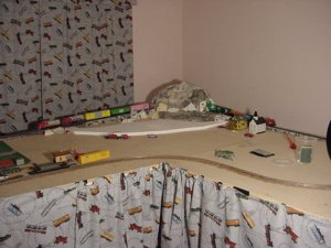

    Here's another view that may show it better. It definitely is ho. Thanks

    If that is HO it looks like you actually have more than just 4' x 8' of space to work with. As best as I can make out the image it looks like you have an 8' x 4' section, and then the bottom of the "L" looks like another 4' x 4' section. If that is the case you actually have a lot of room to work with for a starter HO layout. If you hadn't already laid the track I would have suggested looking at some beginner layout track plans form Atlas, or Model Railroader has some nice ones...but as is it looks like you could run parrallel to the track you have, or you have plenty of room to go up and run an overhead section of track above the track you have now. The tunnel section could pose a problem, the hole isn't large enough for a double mainline, but you could tweak it a little maybe to have the second line run over the first...but you are looking at building pretty high at that point...which means steep grades.
    Most improtantly right now, before you make your descision is to consider the grades and like you said early, "pinching" track. No matter how nice the layout plan is, it won't be fun if you can't keep the trains running on it. Vice Versa the simplest can be the most fun if it runs well and reliably. My suggestion, before you think of running an entirely seperate mainline, think about where you may want some sidings, switches, etc...

    I will make the assumption that you have "three 4' squares " in an 'L' shape, and that you probably have 18" radius curves already laid down. I'm not sure your engines would like running on 15" curves, but to set up a second loop inside, that's what you'd need (no greater than 16").
    You could start at the base of the mountain, at a level slightly above the existing track, and get enough height to cross the existing track in the area of the inside curve. This would be easier if you filled in the angle of the 'L' with a small triangle to help carry the new loop through the corner. This would give you the option of bringing sidings off the existing track, and also off the new loop, and possibly allow you to use a larger radius curve.

    Heidi, it looks like most of your track now is out close to the edge, which means, even with flex track, the curves are about 22". If you lay another track just inside of it, an average 18-19" radius would do for what you want. One thing, all the others are right, it won't be prototypical, but it will work. I have done it many times. When you lay the track, be VERY careful that everything is nearly perfect, because the tighter turn will agravate any flaw.
    You can check, by laying one curve, plus a little. Attach wires to it and try running a loco over it. If it works, fine. If not, THEN you know changes must be made.

    I see in your picture that you have alot on inner space. Don't waste it! Add a second layout in there. Even add a yard in which the two line can share.
