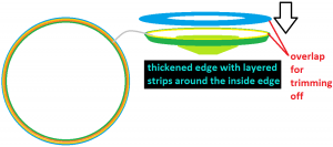

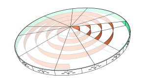

I think that a fundamental design approach should be considered. A outer ring should encompass the two saucer sides, as the norm, but these should be recessed the thickness of 110 lb. card stock, the inner ring should be thick, which would allow the fitting in sections for the final outside pieces. Done with care and research, panel lines could could be used as guidance, and these panel lines could be shaped such that instead of being perpendicular lines, the look like the pic below. The Green piece is the "inside glue it on who cares how it looks piece", and the outside ring is the "finished" outside. I did this in around 10 minutes, forgive the simplicity. The TOS Enterprise does have panel lines, though they are barely visible. You can see them on the original model used for the show. I would hate to see them fill them in and make smooth because in reality, it would be very hard to make a ship like that, which is why I believe (opinion here) on all other Star Trek ships they show segmented lines. Just an idea. I use spirals on wheels to make them go together easier. You would have to make a graduated spiral for what I showed but the Enterprise could use much smaller spirals, just enough to give rigidity. :)

that's a very good idea!!! I also thought of expanding the upper saucer outside ring by 4cm , so there would be an overlap on the join, and then after gluing, trim off the excess and sand with a disposable nail file.

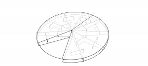

They stiffen the heck out of wheels. In all honesty, these should be built with formers set up from the center point in a polar Array, with pieces of card stock locating and supporting the formers.
Again, quick and dirty. A picture speaks 1000 words, this would be done properly with the formers being spaced equally around the center. I think the Spiral is better for very small things, like wheels, or small scale spaceships.:

I think you have to have supports inside or the saucer will eventually warp on the top and bottom sides. The outside ring will keep, but you would have no rigidity. It's easy enough to cut holes, or place supports so they act as light conduits. Unseen, it need not be symmetric. This, done thoughtfully, would make for an excellent sound mount for the saucer to the support. :)

I believe that you are right on that. Ron has some circular supports and a cone in the middle included with the model. the large blow up has something like you designed for both the refit and the tos. im thinking a white or yellow led in a piece of Styrofoam where the rim windows are would light them up well, and with black paper glued to the outside, would minimize light leaks. printing the backside of the model page black will help, providing that all the seams are backed with foil or black paper.
