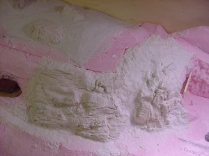

Steve, I am assuming that have a base to anchor your casting to. I used 2 inch foam and formed the rought contours of my mountains. I like to adhere my castings with a stuff called "Sculptamold". It can be found in most craft stores, basically a paper mache/plaster and it must have some adhesive of some sort in it. I wet my castings first and mortor the stuff on the back of the casting and push it into place on the foam. What oozes out can be shaped and additional detail can be added around your casting. It will take three or four days for the stuff to dry. Here is a picture of the rock outcropping I just added an hour ago on one of my new "N" scale modules.
