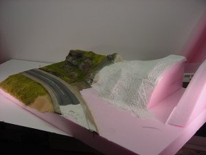

Have to give a little talk on my method of using plaster rock mold casting. Made up this little scene to show the method I use.

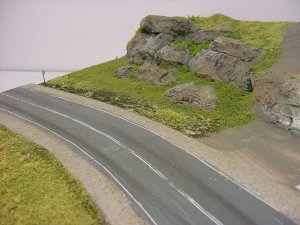

Bill Pontin
Tried a couple of different things here. First I read that the cork rail roadbed make great road shoulders. Came out rather good I thought. The road is sheetrock compound, great stuff since it can be lightly sanded when dry and then smoothed beautifully with a wet sponge. The grass in the forground I glued down a piece of felt fabric. The type you see in the craft stores sold by little squares. Choose a light tan color and glued it onto the foam. When dry I painted it with some laytex junk I had laying around, teased up the strands with a little wire brush, lightly sprayed on some adhesive and added ground Woodland scenic ground foam. Came out okay, too much work and the same results can be had with different textures of ground foam. (Other side of the road.)

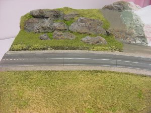

Bill Pontin
The lines in the road are made with a white gell ball point marking pen. I use a piece of plumbing solder as a guide. It can be bent to contour the road and used as an edge to guide the pen. The pen I found will skip if the surface is too glossy. Still playing around with that. Note the lines are white, this is a typical 50's road before we went to yellow centerlines

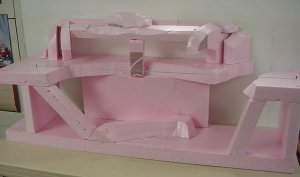

Bill Pontin
love using the foam for the framework and support. It is so easy to cut and glue. Was using a latex foam adhesive but found that a hot glue gun works better and sets up so much faster. Youch, youch though, that glue does love to drip onto your fingers. Here is a four foot module I have started, this is the framework only. Will build the wood frame to fit later.
Bill Pontin
Few more supports and then I will start to cover with the plaster cloth. From there I will add the rock plaster castings. I plaster the back of the casting with a product called Sculptamold. Great stuff, something like a real fine paper machee (sp?) probably has some plaster and glue mixed in. Stuff adheres great, very slow drying so plenty of time to work it. It does take a good week to dry completely. Just about as hard as plaster but half the weight.

sumpter250
multiscale modelbuilder
Bill,
I know you meant this as a rock building tutorial, but I really like the road. Using the cork as road shoulder, do you have the bevel facing the road, or facing out ?, and do you fill the roadway up to the level of the cork?
Nice looking scene!
Pete
