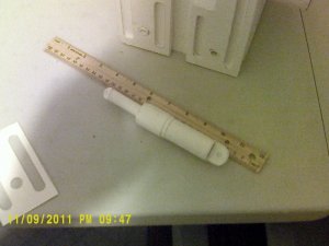

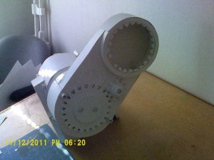

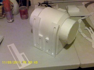

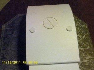

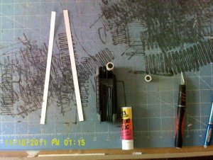

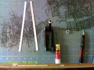

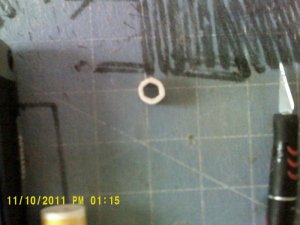

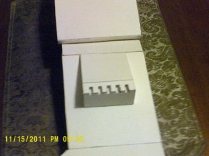

Thank you.For the bolts I wraped a thin sheet of paper around a allen key with glue stick.It holds the hex shape in the center and rounds out on the outside.
Wow, that is such a good idea for bolts, I have never heard that technique before, and it would work for anything. You could slide the tube p, fill with glue, and just cut off this "extrusion", as you go along. Excellent tip! Thanks! That is Yankee ingenuity folks, Yep, we are Yankees!!:wave7:balloon6

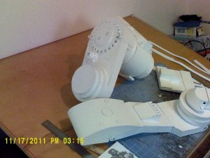

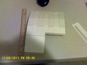

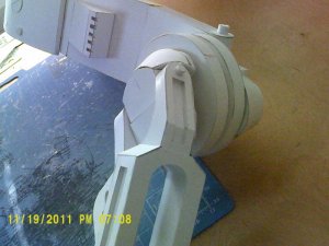

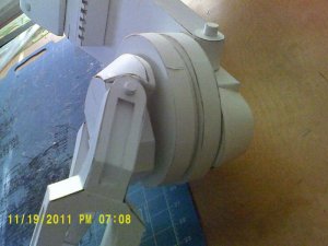

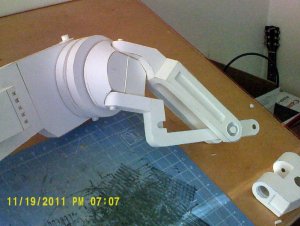

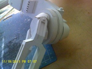

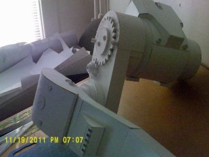

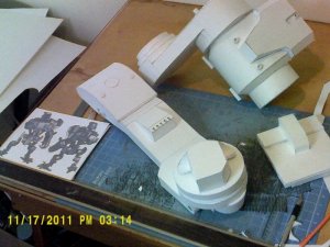

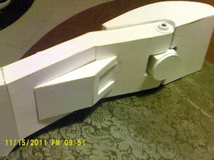

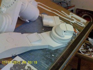

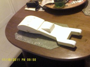

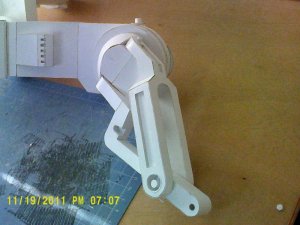

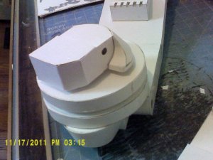

Thank you all for your kind words.Working on the legs this weekend.I found that paper has a grain so I switch the direction of the paper and build up in 3 layers the walls it becomes as strong as plywood "Plypaper". And a little foam board helps.002.jpg
The gears, the arms, all the assemblies are so excellent!! This seems more than a model? I don't even know what to call it? You may have joined the ranks of the far and few with this one. Incredible!:inw:
