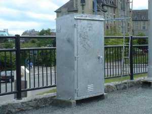

I've been studying up on the subject of resin casting and am considering making some relay boxes for my small n-scale shelf layout.
Attached is a photo of the prototype box on the local RR.
After completing a scale drawing, I now realize how darn small this thing is in n-scale! Now I'm wondering how to make an accurate master?
