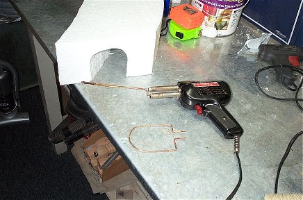

Don't despair just yet....I used to cut out landing gear boxes out of foam wings for my R/C aircraft. I used my Weller soldering gun, and replaced the soldering tip with a pre-formed heavy gauge SOLID copper wire, about 12-14 gauge. It cut through foam like a hot knife through butter..!! Maybe you could rig something like this up to help you cut down on the mess...!! Just don't press the trigger for too long...the gun might give up the ghost....
Doc Holliday
Oct 27, 2002
613
Big Valley, California
I did what Steamhead did. I bend the copper wire into the shape I want to cut out. Here's a pic of my tunnel boring knife.
Doc
