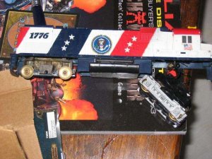

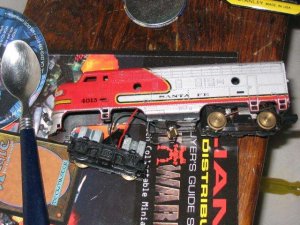

As some might have Read on G/O/S board, I pulled a bunch of old Lionel stuff out of my parent's attic.
At the same time, I recovered small parts of my old Tyco Train sets, including a Santa Fe Warbonnet F-Unit, and one of the Bicentenial Engines. Both units had the trucks hanging down and missing parts, but the shells are still in good shape.
Are there other, more reliable motors these shells will fit over?
Both units are Tyco/Mantua.
The F-Unit is an F9-A Santa Fe passenger:
The Bicentennial looksa like this:
This are 'like-new' pics, while mine are in much sadder shape.

Those really aren't in that bad of shape. Ive fixed ones in worse shape. If the motors run the hardest thing will be remounting the head lights. Which can be done by drilling a small hole where the plastic tab broke off and mount the light bracket with a small screw
From looking at the photos, The only things I see missing is a couple of sideframes and couplers. If you remove the upper part of the motor mount from the C430 shell it will snap right back on to the bottom part, that's the easiest way to do it.
If the one Traimmasta has isn't the new version then let me know, I have a sideframe for the C430.
As for the F unit I'm looking for a couple of those sideframes myself.
The couplers can be replaced with Athearn couplers(I'm sure a number of us HOers will send you a handfull of if you ask) and bushings from KD #20 series couplers.

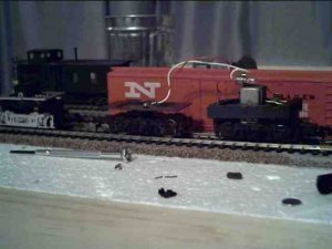

Are you still looking to repair these locomotives? If so, a recent box lot I've aquired had these parts in it. If you're interested, drop me an email or pm. To the left is a power truck for the Alco and to the right is the complete running gear for the F unit. I can't tell if they're drop in replacements but they should do the trick. Both are in very good condition needing only cleaning and a new coupler on the Alco truck.
