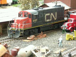

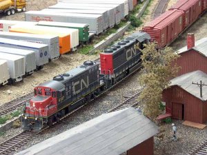

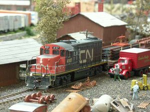

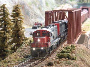

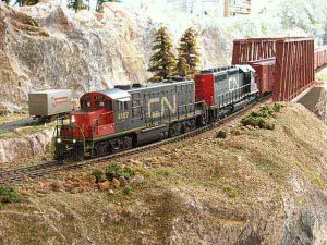

With a trip down memory lane as I wanted to get my original Tyco GP9-18 hybrid on the rails again. This loco was part of the Tyco train set that I got when I was a kid back in the early 1970's. You should have seen what the shell of the poor HO loco looked like after I had finished using it when I was a kid 30 years ago. Here's a description of what it looked like before:
  • Cab window frames completely wrecked and broken
  • Crack in the roof and engine horn missing.
  • Back steps of loco completely broken off but piece recovered.
  • Hand rails mostly all rusty and somewhat bent.
  • The electronics were completely shot, motor was toast and the driving wheels were cracked.
What to do? Couldn't throw out something of high sentimental value as this was the reason I got into the hobby again. So, I entrused an absolute craftsman who custom model builds and paints and asked what he could do with it. Well, after a few months this is the result. I've attached a few pic's for you of the new creation.
Your probably asking yourself how can this run if the guts were all completely shot. Well, I bought the undecorated GP9 Trainline from Walthers, removed the shell and it was an extremely close fit with only minimal modifications to the Tyco shell from what my buddy Jeff had said. Here's what he had to do:
  • Remove the old broken cab window frame and repair the crack in the roof.
  • Graft on a custom window front cab section with more prototype number boards.
  • Repair front pilot and include etched front steps for crews and install MU hoses.
  • Install LED ditch lights on front. I know there is supposed to be on the back but didn't want to go overboard with this as I was going to run it as a lead engine anyway.
  • Make modifications to the shell to include a speaker for sound.
  • Repair the back walkway and re attach the stairs with reinforcement.
  • Custom painted and weathered with long Kadee's installed.
And so after 30 years, here she is running on my friends layout , with DCC sound too.
The other photos are of it leading a customized SD40 that my friend Jeff had custom modified, painted and weathered too.
It took me about 1 hour to calibrate the two locomotives so they would run in consist in near perfection team work and wow do they ever haul alot together.
With a vision, the possibilities are limitless. I'm grateful for getting this loco back on the rails for me to enjoy for another 30 years or so.
Happy railroading all:wave:
