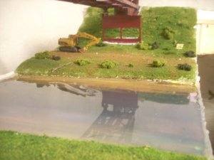

Go to a craft store, find some accrylic paints in the color you want and use WS realistic water. It is great for calm water. Its priced decently also. I thats what Ive used. JUST MAKE SURE THE AREA ITS TO BE USED ON IS VERY LEVEL!wall1
