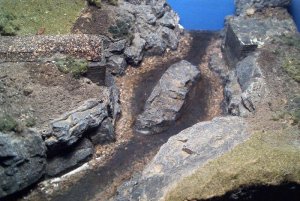

Enviro-Tex...
Hello,Ian.
I dug out and dusted off part of an old n scale shelf layout I was working on whilst in high school. This one never got really finished, but the water did get poured. I used Enviro-Tex, and was quite happy with my very first water attempt. I put in the rocks and riverbed, glued them down really thoroughly and let it dry. Enviro-Tex must be fairly forgiving, as I suspect I poured a layer way thicker than recommended.
Here's an overall shot.

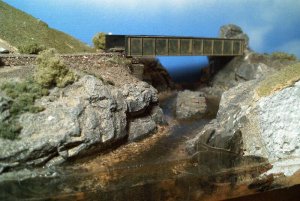

More...
As you can see, the Enviro-Tex really does find a way to leak out if at all possible. I was sure that I had built an acceptable "dam" to hold it in, and there was a bit of scrabbling to plug gaps before the floor got decorated!
In this shot, you can see how it dries to a mirror-like surface. Quite inappropriate for a small mountainy stream, but as it was my first try, I was loathe to get too fancy. If you have the patience, the Enviro-Tex can be manipulated with a flat ended screwdriver to create ridges, waves, etc. I've heard that it does require a fair bit of time, however, as the E-T has a tendency to flatten right back out.
Here's a top picture.

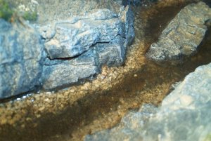

Here's what I liked best about the E-T. The ability to have a REAL 3-D riverbed. Below my rock castings, I glued in some cat litter, trying to put the larger bits closer to the surface, smaller bits lower in the "water", and then a layer of darker dirt for the bottom.
I had planned to add some surface ripples, or even a little whitewater using gloss medium, but never got around to it.
I found the E-T very simple to use, and was happy with the results.
