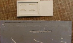

Val, The only photos I took were the ones I posted of the castings. I went downstairs and found the mold, I have already disassembled the master. Here is a photo of the mold, with the master for the arches. I made the master for the row of bricks by cutting a lot of pieces from strip styrene with a chopper, then glued them to another strip of styrene, which was glued to a flat piece of styrene sheet, just like the arch master. I spaced them with strip wood which wouldn't get glued in the process. It was about 7" long. Then I was able to just pour as many copies as I needed. Just make a dam, I used 1/4" square styrene strip, to hold the liquid latex mold material. Obvious in the photo.

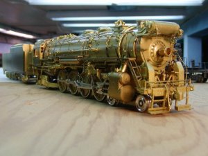

Check their website at www.smooth-on.com Since I was downstairs to take these shots, I looked around for something else to shoot without setting up lights. Here is my NYC L2a, patiently waiting for Soundtraxx to release their Tsunami decoder. This is my favorite NYC steam loco. Completely off topic, but who cares?

Yes Belg, it's brass. It took me a couple years to finally win one on ebay. I believe there were only 50 pcs. made, and they don't appear often. The first two I bid on wound up going for well over what I wanted to spend, I finally got lucky.

Pete, Surely you jest! After I install the sound and I'm happy with the way it runs, Blake will paint it. I want cam activated chuff and want to see if I'll need to add pickups before it gets painted. It runs nicely now, but I want to see if the sound drops out at turnouts, etc. before proceeding. Where are those Tsunami's?
