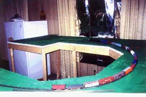

I didn't worry about the window. I just went ahead and built the layout.

Looks like a good start Seems like you have a lot of potential there. The window may een give you more of a sense of depth if you incorporate it in the backdrop.
