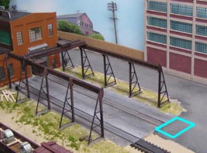

I'm planning to build a small gear house at the end of the track to power the cable. Its position is shown by the blue line. Now I wonder if I need to cut out a channel between those tracks for the cable. Any suggestions?
Val

The installation I'll be modeling did not have a channel. I wouldn't want to be the poor lunk that has to haul the cable 2-300 feet everytime a new string of full cars gets dropped off. Nice mill :thumb:
