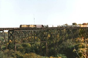

Kate Shelley High Bridge. The longest and tallest
double track bridge in the United States! Boone, Iowa
(new pic)

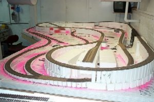

I had a similar problem when I started. The attached poor pic shows the largest trestle on the far right. The trestle spans a lake which will extend to the left under the next two sets of tracks. Two more trestles will be added under these tracks. Originally, the right two lines were much closer together. I finally ended up re-aligning them to increase the separation to allow for the trestle base widths.
The height of my largest trestle was based on the highest I could get using 4% max grades. I cheated up by 2" by using a layer of 2" foam over my entire layout that will be cut out for the lake. The water surface will be directly on the plywood. I'm just finishing the other two trestles and will post some pics when I get them in place.

Del,
I glued the foam inclines and risers in place using Liquid Nails for Projects for Foam. Some guys use white or yellow glue or caulk. I used "T" pins to hold it in place while the adhesive dried. It is very strong. I had to pull up some of the foam to create the lake under the trestle and had a heck of a time getting it up. As for the dates for steel trestles, I' not sure. My guess would be steel began to become popular around the turn of the century. I'm using wood trestles since I'm way out west circa 1880 where steel mills were few and far between.
