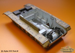

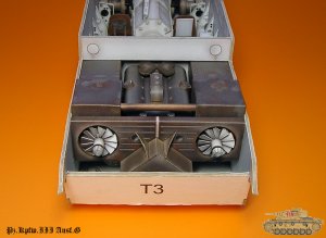

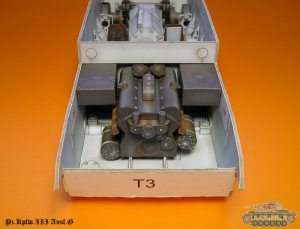

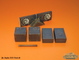

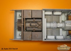

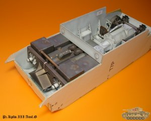

Assembled fuel tanks, accumulator box, oil tank and radiator
Radiator was a little bit large, so i was in need to narrow it
Also thee is a mistake with fuel tanks - they not mirrored
I cut right tank to pieces and glued upper part right. But gluing place for connecting tube
can not be hidden, so i only painted it
Also, on the pictures shown steps to glue all parts in place
First accumulator box and oil tank
Second engine
Third fuel tanks
Last radiator
Engine compartment finished! :p

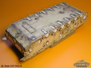

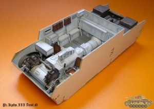

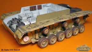

I finished the interior. Visors was glued upside down. Already fixed it :)
Next step was to glue outer skin. I was in need to make some adjustments, but in general it fitted OK.
A lot time was taken to cut out, paint and glue all the hatches and stuff.
I suggest avoiding glue part 1i on cardboard, because afterwards you need to shape it

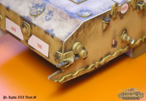

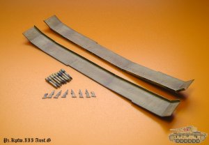

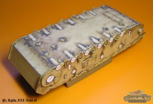

I glued some additional parts to outer side of hull. Also assembled tensioning mechanism.
You can give up on part 3g. It will only interfere
After this step i moved to cut out huge amount of wheels parts and assembled one for testing. No real problems, only outer strip, part 71f was too short.

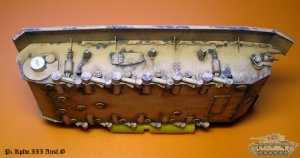

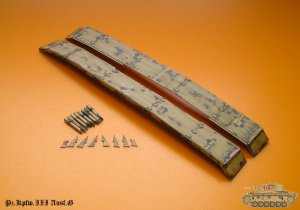

In breaks, between cutting out parts, I assembled mudguards and glued them to place.
Part 41, supporting beam, will be glued later, after I'll figure out how much space is needed to insert upper hull part

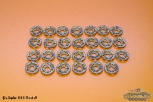

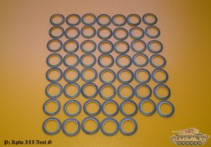

In the meanwhile I continued with wheels and am presenting you assembling conveyor in pictures. Step by step :)
There was only one problem - outer strip was too short, but eventually it will be covered with tracks

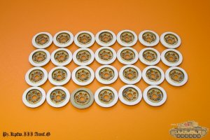

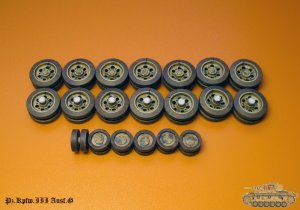

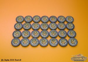

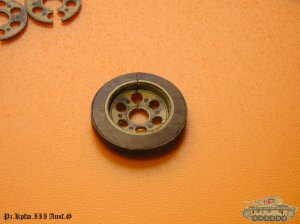

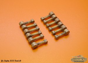

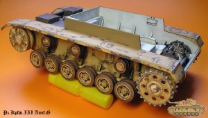

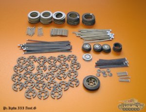

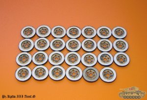

Wheels placed on axis. Rollers and swinging arms assembeld.
Axis of the wheels must be reduced in diameter or it will not enter the whole.
Swinging arms must be assembled with extra care and measurement. Connecting beams are too large in diameter.
I advise not to glue part 1t1 on cardboard or it will interfere with swinging arms later.
Happy New Year!

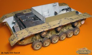

I finished dumpers and started to glue suspention and wheels to the body
First dumpers and then swinging arms
Next upper rollers and then main wheels

This is the part that pains me about certain types of models. The suspension components on this could be made to work but it is ridiculous as it's a model, not a toy. The machinists part of me wants to make the components work to keep options open. I would have been so tempted to try and make the suspension workable but this is because your model looks so real, it really seems like you are building a miniature tank, not a model of a tank. I only get like this when I see what I feel is the best of the best the top level models. That's what this is, this is the best of the best, and the big little oaf kid inside of me would just want to play with it till I broke it. Nowadays, I blame it on my 12 year old. We'll dogfight in some biplane models and just like the real fights, we have collided mid air. They never look quite the same afterwards and I have lost some nice models that way, but we sure have a lot of fun! This is fantastic, Thank You for sharing this with us! :)

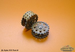

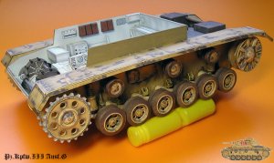

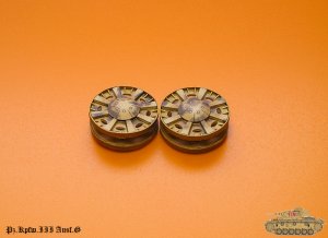

Thank you Zathros. If the design is right (like in Halinski Sherman), there is no problem to make suspension workable, but not here... I just pray that it will hold the weight and not colapse :D

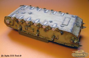

I took a little breake and now I'am trying to get in line again
Front driving wheels and back wheels are done and glued to places
There is a need to watch carefuly and aline all the wheels in one line
Did a test build of several tracks to look if it matches the driving wheels. Looks OK, but I've narrowed a little the thikness of wheels, about 0.5 mm.
