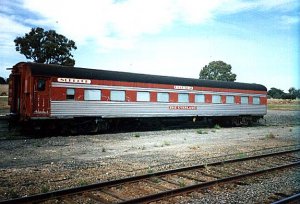

I'm doing up an "Overland Express" which ran between Melbourne and Adelaide (overnight) from the late 40's and still runs today using a lot of the original cars. But the railways have scratched them and bashed them a bit over the last 40 odd years. ;)
This is the era I'm doing:

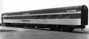

... and the cars were looking a little scratched and bashed a few years ago.

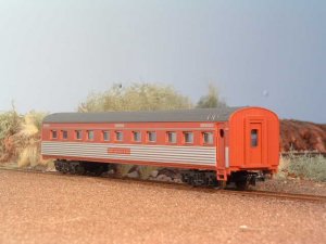

But as they are supplied (by Lima) they are a little, shall I say.... lacking in detail. The windows aren't right, (silver/chrome edging that shouldn't be there) neither is the signage, (too small, and only a two colour paint job, instead of a third for the signage) and there is no underbody detail.

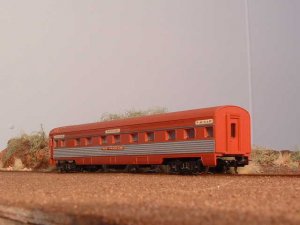

correct it with some detail signage decal packages, and a molded underbody detail kit (which I had to remove the car floor to fit correctly), and remove the silver window edgeing, and we have something a little closer to what it is meant to be.

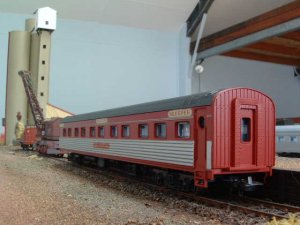

Got another 8 to do like that, plus power/generator van, and dining car. :eek: Took 5 hours to do that one!!
Each car was individualy named, which generic model manufacturers, of course, can't do. So it's decal kits have to do that bit.
This one is "Weroni" as put in service in 1948.

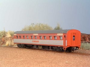

.... and the ready to run "Weroni", with decals, windows, and underbody "bashed" more appropriately. :)
