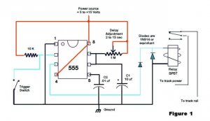

I think that is why i'm so drawn into this hobby becuase of the potential to fiddle ;). I am no electronics expert but i bet w/ a couple resistors a switch some duct tape and an acorn i could make a small nuclear reactor on my layout :).
I'm interested to see how you designed your delay circuit. I was thinking about doing something like that for one of my tee crossings, where if there is a train w/in a certain proximity it kills the power to the crossing track section.

Hi YmeBP :wave:
Here is a simple delay circuit that will reduce rear end collisions. You'll need to decide what kind of trigger mechanism that would work best for you, IR, magnetic, mechanical etc. The sensor would be mounted at the beginning of a wiring block and the cutoff would apply to the block that it had just left. Any train entering that block from behind would be stopped while the first train kept on going. It would be a little trickier for tracks that handle traffic in two directions, but not too much so.

Pitchwife said:
Hi YmeBP :wave:
That is a thing of beauty! I wonder how big are your power blocks?
You can make them as long or as short as necessary. They should be able to hold the longest train that you run thru them. That way even if the caboose is about to get clobbered, the engine of the front train will trigger the circuit and stop the following train in time. The delay should be set for a long enough period for the first train to get some distance or else be switched onto a siding.
You don't even need them on all wiring blocks, just the ones that get congested with a lot of traffic. It's a versatile little circuit. It can also be used to trigger crossing bells and/or gates, track signals and traffic control, other animation. Have someone come out of a house to wave at the train. A lot of different applications.
