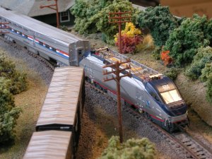

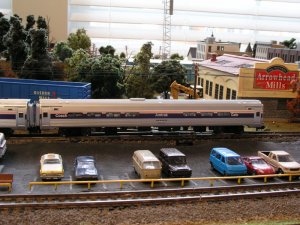

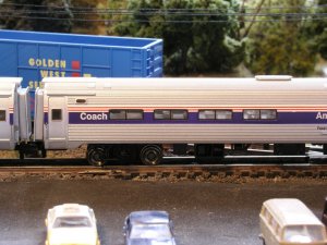

Here's those pictures I promised...
Bachmann Amfleet Coach and HHP-8. Good looking coaches, too bad they don't roll easily. The HHP-8 is a strong litte engine, but can only pull three cars max. (It can pull longer 6 car consists of Concor or Kato coaches.) I'm still working on ways to decrease the axle/wheel set friction.
