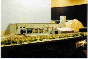

I had built a potash mine on my previous layout and am now rebuilding it to go on my current layout.
Here is a photo of the original one.

That's an interesting structure Robin. Are you going to alter it a lot or stick close to the original? Get ready for another great thread folks!

The will be changes Ralph as the space is different and mines have modernised some.
To give you some idea of how potash is mined.
All but one of Saskatchewan's Potash mines are conventional in that a vertical shaft has been sunk to intercept the potash beds. Self propelled continuous borers cut into the potash, creating 'rooms', or tunnels, which may stretch several kilometres from the bottom of the shaft.
The continuous boreborer is a massive machine equipped with two or four contra-rotating heads that cut out many tonnes of ore every hour. The ore is passed through the borer, then then loaded into electric shuttle cars to be carried to underground crushers near the shaft. In due course the ore is carried to the surface.
In the mines milling complex,the raw ore must be broken up to separate the individual crystals of potassium chloride from impurities, notably salt and clay. The ore is crushed, mixed with brine, ground, chafed, and mixed with chemical reagents. The crystals are skimmed off and spun in a centrifuge, then dried and graded.
The finished product, known as muriate of potash is stored in dome shaped warehouses to await shipment. Potash is used in the making of commercial fertilizer.

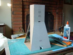

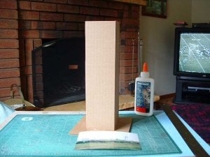

I have started by making the main shaft head. As most often, I start by making the base shape out of corrugated cardboard.
The headgear is 150 feet high. The top is 40 ft. by 40ft. and the base is 80 ft. by 80 ft,

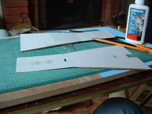

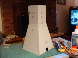

Then the other two sides. This is now ready to be painted

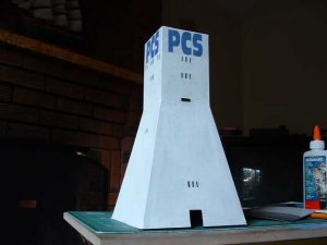

The main headgear is ready for some more weathering and to be installed on my layout. There are many more structures that are needed to make up this mine.
I did the letters with Corel Xara.

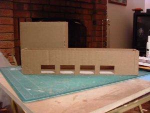

This section of buildings will serve to load the potash into gondolas.

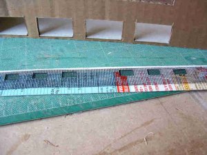

I am now using fibre window screening for windows as the squares are smaller than the flex tape is. Here I glued the screening on the back of what will be a wall. Now I could have cut the screening a bit smaller and will do that next time

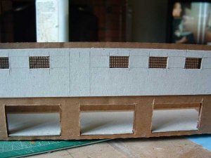

Here is what the wall looks like. Painting to follow.
