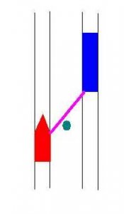

The red Steam engine is pushing (poling) the blue boxcar
Rather than back up down the yard track and switch over behind the blue car... it's "Easier and uses less fuel" to have a man (Green circle) use a pole (Purple line) between the pockets on the Engine and car... to push the car in order to position it. (set in place).
Yes this is dangerous.. Yes the pole could slip... Yes the "employee" could conceivably be thrown backwards and land on the rails in front of the engine :( Ewww

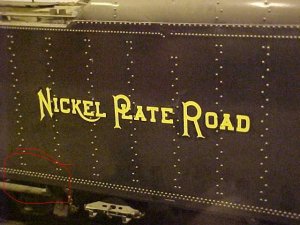

Here's the 765's....

The supports are essentially hooks with a side/end. You can sort of see it in the photo I posted of the 765's tender.
