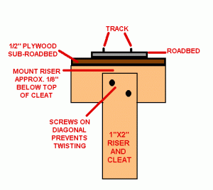

What does cause trackage to have a "roller coaster" look is not from warpage but improperly spaced and constructed risers. Risers and joists should be no more than 16" on center and risers should be constructed as shown in the following pic using a cleat. By placing the cleat approx. 1/8" above the riser the load (plywood subroadbed) is more evenly distributed and "humps and sags" don't occur.
Hope this helped.
