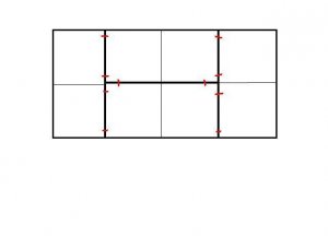

I think that Wayne is suggesting that you basically create a shallow, upside-down box using 3/8 ply and 1x2 framing. You would then put the styrofoam on top.
Take a look at the www.hotrak.ca and www.railwaybob.com links I provided earlier. You can frame up a sectional 4x6 or 4x8 layout out of 3 or 4 2foot x 4foot modules. They will not need a plywood deck - only the 1x4 or 1x5 framing with a single 1x2 or 1x3 crossbrace. The sections can be bolted or clamped together, and then taken down and stored when not in use.
Two sections can be packaged together with "carry plates". Each pair should weigh under 40 pounds, depending on how you complete the scenery, etc. (Hint - plaster landscaping is heavy ;) :D).
I have attached a quick diagram to show how you might divide up a 4x8 table. For 4x6, just leave off one end section. :)
Hope that helps.
Andrew
