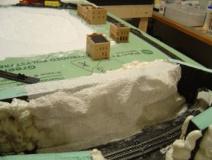

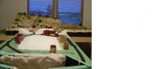

:wave:In expanding my layout i decided to try the expanding foam in a can. I think this may work for small hills and mountains. Seem a little expensive to do a large area with. What do you think?

Looks good. Dave Frary did an article in MR a while back (mid 1990s??) about doing scenery with the white styrofoam ("beadboard") and expanding foam. Seems very effective, and possibly cheaper than layers of extruded (pink or blue) foam.
Isee you have covered the foam with (plaster soaked?) paper towel. Have you tried carving and/or painting the foam directly?

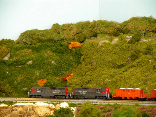

I use a lot of it on the layout. When dry its easy to cut and shape, takes scenery, paint, scenic paste. Remember that it does EXPAND... about twice the size you sprayed....
This is one corner with most all the scenery having a "Great Stuff" base...
