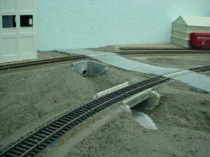

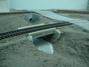

Here are two photos of the ditch retaining wall with culvert.
Edit: Oops, the first photo is the wrong photo. I'll get the other one.

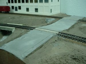

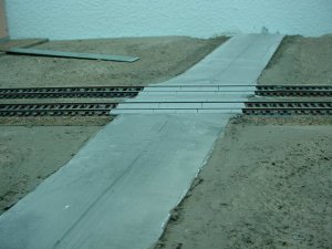

Josh, the roads are made out of "foam putty" which is a lightweight alternative to drywall compound. Eveyrhting still needs paint/weathering, that will come later.
One more similar photo:

Josh, I mixed some black craft paint into the putty which gave it the gray color. It dries a little lighter than it looks when wet. I had to do several applications with a putty knife that was a little wider than the road. It helps to smooth the putty if you wet the knife.
The putty will end up wider than the road, possibly with some big glops. Don't worry about that, it will come right up. Also, I made the roads a bit wider than the final result. After it dried, I went back with a hobby knife and cut the excess foam away and pulled it up, leaving a nice edge.

I did several layers to build up for the grade crossings, plus there was a learning curve on getting smooth results. Apply, let dry, apply again, the bottom coats can be used for practicing. I still need to do some touch-up and mild sanding, then some weathering. Once I add stripes, I think it will look good.
