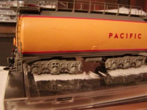

George, sorry to say I don't have an Athearn to try it on. I just received a Lionel Turbine which I will be relettering for my road, so I tried the Walthers solvaset on it. Applied just as I wrote above, and the lettering is painted on, just as the Life Like and Bowser were, I don't know of any manufacturer using decals. I suppose you figured if I'm using Solvaset I must be removing decals. Nope. Here is a photo of the result. You can't see it in the photo, but there is a noticable difference in the finish where the lettering was, when you hold it to the light at certain angles. As I mentioned before, a bit of gloss and you can reletter then apply the finish of your choice. Oops, I just typed all this in the quick reply, so can't attach the photo, it will follow in next post!

I just reread my advice above and I should add that the first application probably won't look like it did anything. When you have a lot of erasure debris, wipe it off, apply more solva set and rub again. It takes awhile. When it starts to come off, it speeds up a lot. A very soft erasure won't work as wellas a harder one. Just be patient tho, as too vigirous a scubbing will scratch the underlaying paint.
