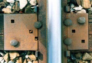

Rail color and reference photos
I'm new to this forum So Hi everyone. The best way to find out what color track really is is spend some time walking along real tracks and carefully looking. Take plenty of reference photos and have them nearby when you paint/balast/weather the track. Try to get some elevated angles looking down. Also take your photos on a bright, overcast day with a white sky and no harsh shadows. The bright sun will cause violent color shifts during the day and casts a sheen on everything making it difficult to perceive the true color. I was amazed at the difference in color accuracy when I did it.
To answer the question though, here in Cincinnati at least, I've found heavily used mainline rail to be a very dark brown. Think more like taking black and mixing a little brown in to it. I think Floquil Roof Brown is very accurate. Sidings tend to be more rusty more like Floquil Rail Brown. Red rust never seems beleivable to me in miniature unless the scale is very large. It's always more brown than red. In general things need to be alot darker, dirtier, and less shiny. Every time I walk around railroad areas I'm always amazed at how filthy everything is. Here is a photo that shows an accurate overall rust color on a heavily used mainline. some areas where darker. This was on the light side.
