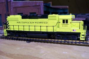

I'm with brakie.
Though some of us don't have a airbrush, or the facilities to use it with, some of us have to resort to spray cans.
This is my Southwick and Winsted GP38-2, completely done using Krylon "Fusion" paint. I really like the way it goes on and decaling is great also. Though, I am having a hard time finding railroad colors, or anything close.
