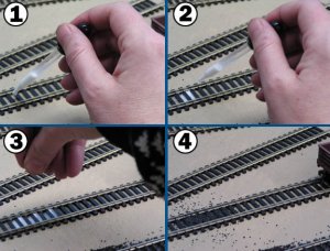

Do you hate scraping stray pieces of ballast off the insides of your track as much as I do? Well, I have found a solution to this problem and it works perfectly.
Most articles say to place the ballast, wet it down with "wet" water or alcohol and then spray with a mixture of white glue/water and a detergent.
Here's a better way. Instead of spraying or brushing the glue, which invariably gets on the ties and rails use an eye dropper.
The slight surface tension in the glue mix causes it to pool between the ties, where it stays. If you put a little too much glue it creeps over to the next space, but not up onto the ties or rails.
Then you simply sprinkle the ballast all over the area. It will only stick where the glue is, and any stray bits can be brushed or vaccuumed away once the glue is dry.
Try it! You'll love it!
Val

Thats a great tip! :thumb:
but wouldnt it take hours to ballast some track that way?
btw I need to get one of those eye dropper's :)
I think the extra time it takes is made up for by the time you don't have to spend picking out all those stray bits that get glued to the flangeways. Personally, I HATE doing that!!
Another cool thing is that this method is so precise, you can use it on turnouts too.
:D Val

Val, I use a variation of your method which seems to work well for me: I put my ballast where I want it "dry". Then, using a 1:1 mix of white glue and water, with a few drops of liquid dish detergent, I apply the water/glue/detergent mix with a medicine dropper.
Thanks for sharing this Val. Many ways to install ballast, this adds one more useful tip to the repertoire.
Personally, i used to lay the ballast and spray (upwards) a fine mist of rubbing alcohol to drizzle down and wet the ballast without disturbing it. Then use an eye dropper or dental type syringe to carefully lay down white glue/alc mix without too much that floats the ballast and sticks to the inside of the rails. What little does i scrape off after, and yes it is annoying. Don't get that much ballast inside the rails this way, but have to be very carefull with the spray not to mess up the dry ballast.
Will try your way next time. Spreading ballast when wet is very hard, but your way is sprinkling, not spreading with a 'spatula', makes a lot of difference and should result in far less spreading work.
Thanks again. Ain't this forum and it's tipsters great?

Some use an empty white glue bottle as their applicator instead of the eye dropper. They say you can work faster that way. I have used the eye dropper method - only way I've done it - but I think I am going to try the other method.
ezdays
Out AZ way
Feb 3, 2003
6,339
Arizona
bigbluetrains.com
An alternate to using an eye dropper is an ink syringe from an ink-jet refill kit. I've got two kinds, one looks like a small accordion and the other type looks like a medical syringe with a dull needle. Works great, holds more, but a bit trickier to control.
