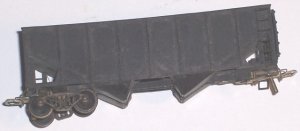

After aquiring this Varney coal hopper project at a train show a few days ago, I could not wait to tear into it! As aquired, it still has its brass loop and hook couplers. Also, it is missing one truck, brake wheel, and end brake appliances. Although the end bracing detail is kind of crude, but it should be ok. Here is the car before disassembly:

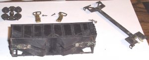

I have removed the truck, frame, and couplers from the body. It appears that frame had sections cut away so that the old couplers were attached to the body. The couplers were attached with 2 screws and white glue. they were not hard to remove. The frame was removed by removing the 2 screws that attached it to the body. Next, the ladders will be removed and the body and frame will be cleaned.

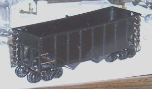

I have installed all of the grab irons to the car body. I decided to go with Athearn trucks with Kadee wheel sets. They appear to be the closest match to those in a photograph of one of the prototypes. After another washing with Dawn, it will be ready for the paint shop. I temporarily reinstalled the frame and trucks.

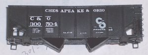

Painted and decaled. I used a mixture of Microscale and Champ decals:
