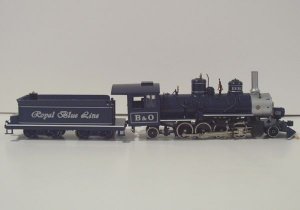

Looks like you made that enginehouse just big enough. I'll be able to park this in there when I come around the pond for an operating session. :D :D :D

She should feel right at home Pete.Setting in there with her two sisters:D I need to get started on my modules pretty quick so I have a place to put the e house.
