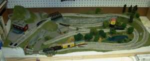

Jason RP - I have some EZ track that I set up periodically for a test track while the layout is still in the planning stages and the EZ track works fine. I use it to break in new loco's and feel very confident leaving a loco run with my back turned while working on other things. Kato is better mainly in the fact that they offer about 10 times the options in turn radius and section sizes.
That said, sectional track is OK for a first time track but flex track offers much more flexiblility. With flex track, curves will almost naturally end up with slight easments which make the cars look much better entering and exiting the corners. With flex track there are fewer seams, meaning fewer connections to go bad and fewer chances for derailment. Yes ballasting track is a time consuming effort but most of us aren't in a race to finish a railroad. Ballasted track looks much better, plastic roadbed will always look like plastic roadbed.
Remember, it's your railroad, do what you feel comfortable with. Below is a picture of my "test" layout that I used to decide what track and equipment I was comfortable with. It was actually built as a display for the shop I work at but I used it as practice before starting my home layout. Total layout size is 42 x 17 so it went together fast and was easy to see progress. It was great practice for landscaping because the layout is small enough that you can move it any way you need to get at certain areas. It is almost finished, just some small details to go. It is Atlas code 80 flex track and snap switches. The point was to show customers that you don't have to spend a fortune to have a nice reliable layout. Minus rolling stock, there is under $300 in the whole layout, including landscaping materials. A train runs on that track 10 hours a day now and other than cleaning the track now and then, it runs pretty much hands free. That is with a 6" radius on the inner loop on the right. You just have to respect that tight radius and only run small steam switchers and 40' or shorter cars.

skipgear, that little layout looks great! Is what I mentioned above with the flextrack what you mean about the easements for the corners- the gaps between the outside rail?

Easements are a gradual tightening of a turn radius to the final radius. With sectional track, when the train gets to a curve, it is a pretty drastic change of direction all at once. This makes a lot of side to side offset between cars at the point they enter the corner. It really shows up on longer cars. Long passenger cars on tighter sectional track can have almost half a car width offset between two cars entering a corner. Easing the corner in from a straight to a gradually tightening radius makes the change of direction happen slower and the cars look more natural. It also helps in keeping longer cars coupled, expecially those with body mount couplers.
I really noticed this after building the layout I posted above. The layout is designed to be taken apart in the middle to create two sections. This was needed to get it in the glass case it was intended for. I used sectional track for the joining sections and two of them were 11.5" 1/2 radius pieces. Even with that larger radius, the cars going through that section of track seem to make a much more drastic curve than even going into the 6.5" radius area. The turns leading into the 6.5" radius gradually get to that point. In reality, only about 1/2 of the 180 deg turn is at the 6.5" radius. The rest of it is easement to make the turn seem more gradual.
Just came from the NMRA train show in Cincinnati. The layout ran for 2 days straight with no derailments and only one stalling issue with a cheap life like diesel. I got my tried and true Bachmann 0-6-0 out and it ran flawless the rest of the event.
Also, anybody wanting to do tight radius corners, don't waste your time trying to do it with rapido couplers. We tried to put on the cheaper lifelike loco and cars first. Stock they wouldn't make the tight corner so I added weight. Weighted they were better but still not reliable. I gave up and put the loco and cars with knuckle couplers on and there were no problems the rest of the day.
