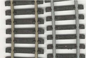

I agree on the color thing too, NS is just a tad brass colored and steel is, well, steel colored like a nail. Left is NS, right is steel.... FRED
