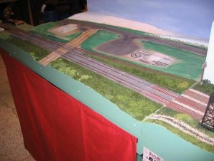

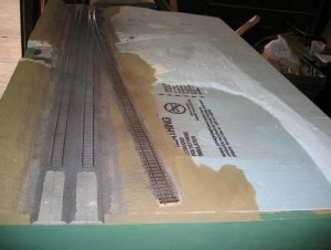

I've been working on an NMRA module for about a year now and I thought I'd post a progress report.
The first picture was taken in February after the track was down, ballasted and wired and the ground contours roughed out.

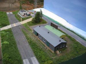

Ha George, I've been wondering how the tracks are joined on modules. Is there a set distance from the edge the fixed track stops? and then a set length of track to join them? That seems like it would be problematic? BTW your ground cover look great!
Nice work; very realistic! :thumb:
SAL,
yes, there are specifications to module building. The track alignment is actually pretty easy to do, and there is a required 'setback' for the rails at the ends...this allows them to be connected with a simple straight piece of Atlas track. The pre-made straights are all the same length, so as long as the setback from the end is at the correct measurement, they fit right up. A little fluctuation may result in some gaps at the joints, but not enough to cause problems most of the time.

Thanks for your comments Scott. The setback, in HO, that David was referring to is 4.5 ". That means a 9" section of track between the modules.
